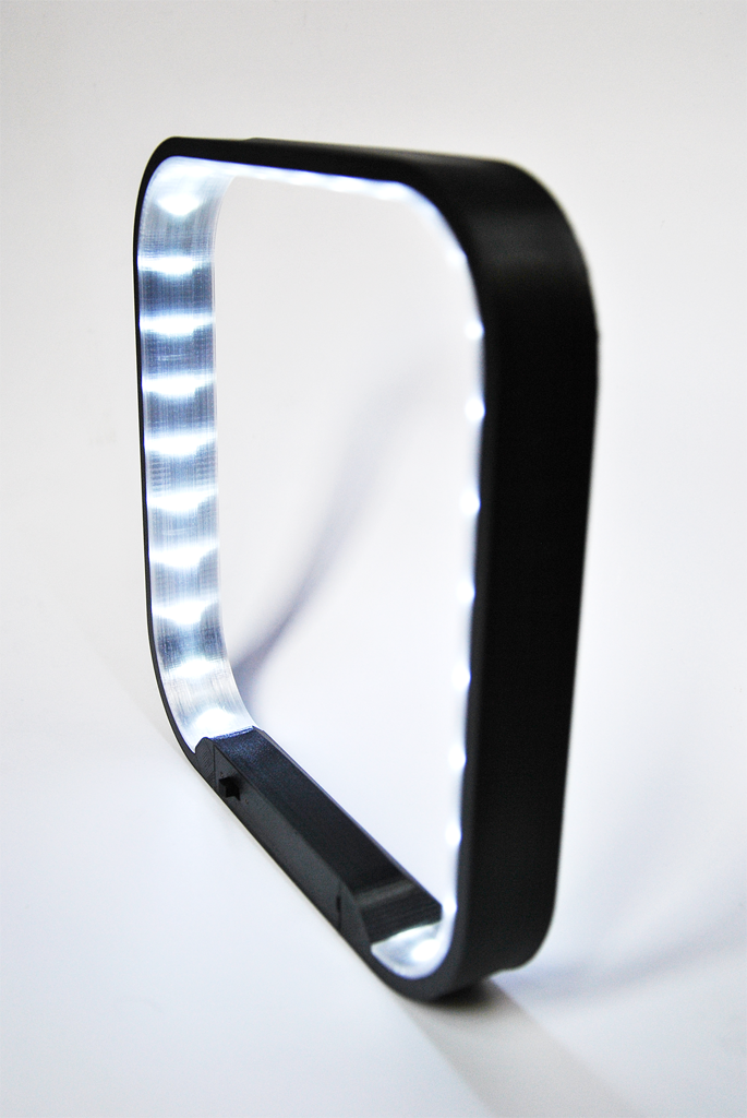

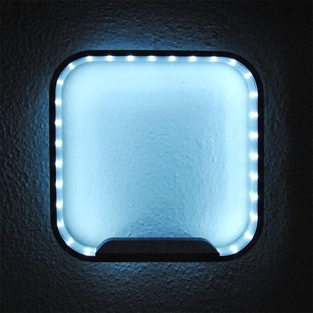

I would like to share with you guys my last project. It is a minimal design LED Lamp 20x20x2.5 Cm. I used Extrudr Black ABS and ColorFabb Transparent XT filaments, a 60 Cm LED Strip and an On/Off Switch. It was printed in an Ultimaker2 at 150 Microns. Every piece was designed so it doesn’t need supports or glue. This way, the lamp is easy to assemble and doesn’t require any finishing.

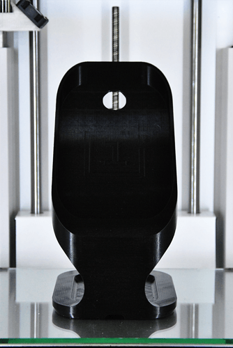

The Black ABS Frame took almost 8 ours at 35 mm/s with a 20% Infill. For the trasparent piece i used “spiralize” in cura so it prints just a thin shell, printed at 35 mm/s it took 1 our an 45 min. The closing piece for the battery case took 25 min at 30 mm/s (because of the snap-fit details i used a slower speed).
