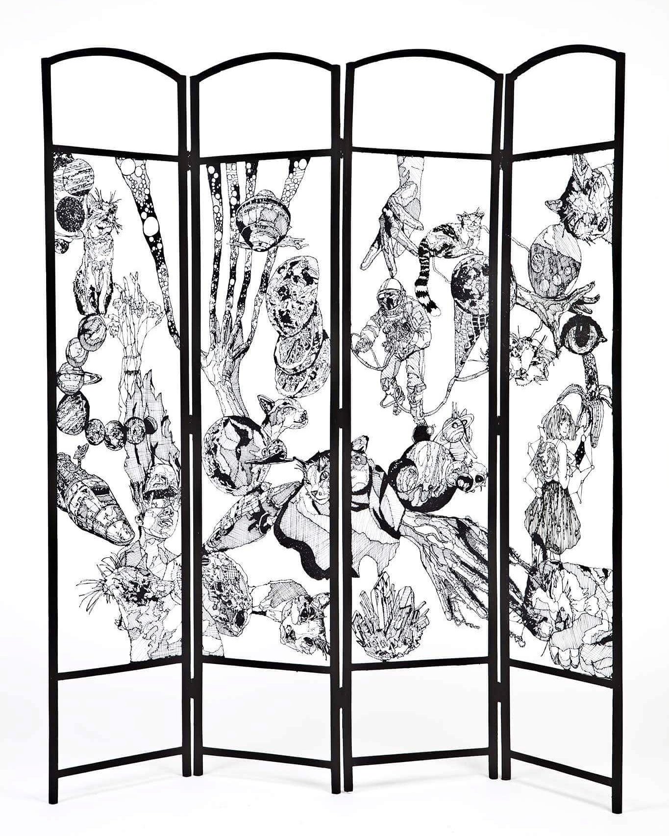

Hello all, Appreciate a bit of help. I use the 3D printing pen to make bespoke furniture and digital 3D printing for the structure base. (Please see images below). I would like to make a lampshade with this hollowed style. Does anyone know the hottest bulb I could get away with for pla and would you recommend a different filament instead? Many thanks.
