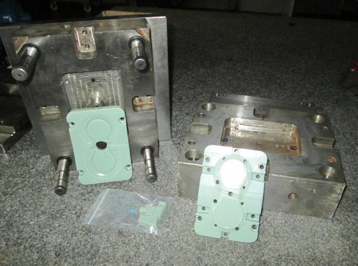

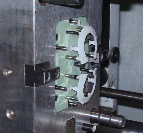

Hello again. I use 3 kinds of material in the mold cavities. The mold base is steel and the cavities are assembly in the mold base. To have a long tool life we need to control the temperature of the PA6 cavities and cool each shot. To cool the cavity I use air pressure flow (30 to 60 seconds).
In this image I have a ABS_Like cavity after 50 shots
The gate is steel material because is the part with more temperature time.

Mold example
