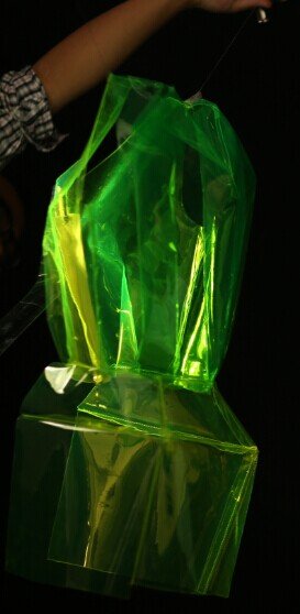

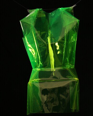

Hello, Everyone, I am fashion designer, I want to explore 3D print for my collection. I am new in this area and short of useful imformation. Attached is a piece of garment made of PVC material(vinyl fabric). I wonder if 3D printer could make this happen?
Any suggestion? Any one provide this kind of service?

I’m afraid the choices are very limited. In terms of desktop 3dprinters I think the only one I can think of that comes close is using an SLA 3d printer and using form labs translucent flexible resin.
The print size is a huge constraint, form1 printers are 125mm cube I think. Printing will take a long time to print is sections and you would have to find and adhesive to fix them together.
You perhaps source a large sla printer like the ā€œsoliditatorā€ has a 250 mm built volume and use that form1 resin perhaps.
Iris van herpen has done a beautiful water like dress before. Her name has become synonymous with 3d fashion. But I’m afraid she used acrylic sheet and heated it to sculpt the form.
Haven’t heard of a FDM filament that is both flexible and transparent.
For your example image, cause it is essentially a drape, I think it might be far easier to create a pattern and cut an appropriately sourced transparent fabric material.
@Paulina is right, If you go down the 3d printing path it will be very expensive, time consuming and probrably achieve a look that is totally different from your original concept.

In the end you’ll want to design them for Nylon SLS printing, since it offers the largest build volume of any system, and is flexible enough to survive wearing. You can even use the flex and design some hook systems for fitting. It’ll also work out to be the cheapest in this large a volume.
However, it won’t work for a clear design.
You could try SLA clear filaments (they’re as a clear as 3d printing can get) but the cost will be massive. It’ll be cheaper to buy a printer and hire someone to run it all day for a month. Logistically it’s unfeasible just for one Look, and you won’t even have the flexibility or strength for it to last long.
FDM printers will give you all sorts of inconsistences. We don’t recommend FDM for any final product unless you want its distinctive texture. The ā€œclearā€ filaments for FDM are not actually clear but end up being opaque when more than 1 layer thick (0.5mm), and you’ll need to be much thicker so your Look doesn’t fall apart.
Long story short: Can’t do clear.
However, if you want to do 3D printing, then yes you can do so using white nylon in an SLS service. Largest print volume I’ve seen (in the world) is 650*350*550 but you may want multiple parts which click or hook together. Contact me if you want more details.
