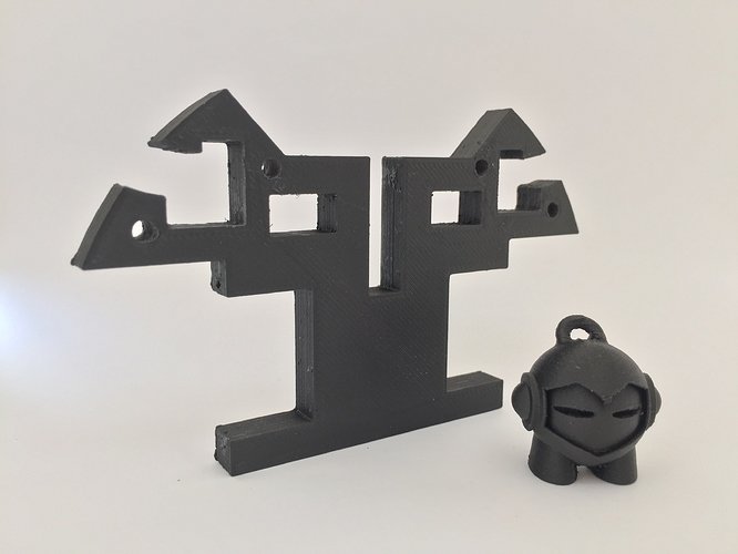

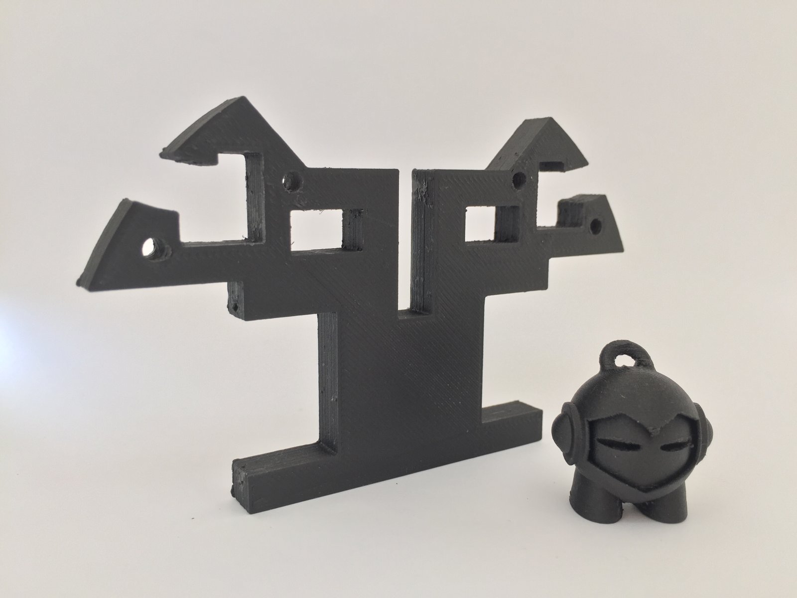

Hey guys,
You read some time ago about @visionflight’s really cool project that is the x0mb1e drone.
Well we got so excited about it here at 3D Hubs that we decided to print one in our Lab! And not a simple PLA drone, we decided to use the awesome Carbon Fiber XT-CF20 from @, in order to achieve an unbreakable machine !
First part was printed today and came out pretty well, you can see it here chillin’ with our XT-CF20 test print Marvin :wink:
We used a leapfrog Creatr HS with this principal settings :
  • Colorfabb XT-CF20 Filament
  • Layer Height : 0,1
  • Extruder temp : 250°C
  • Printing speed : 3000 mm/min
  • Extrusion multiplier : 1,20 (Flow 120%)
  • Infill : 50%
Unfortunately we enabled the supports and the horizontal holes are filled with Carbon fiber supports… So don’t forget to disable support if you plan on printing the X01 drone !
Anyway we still have some tweaks and improvement for the settings to make the best out of this material ! If you have any tips feel free to share :wink:
Hope you guys like it, will keep you updated during the whole process !
Cheers !
- 3D Hubs Lab’s Team -

I would maybe dial back the extrusion multiplier…maybe to about 105%

Thanks Steven for the Hint.
I’ve now set it to 110% and getting slightly better result :wink:
