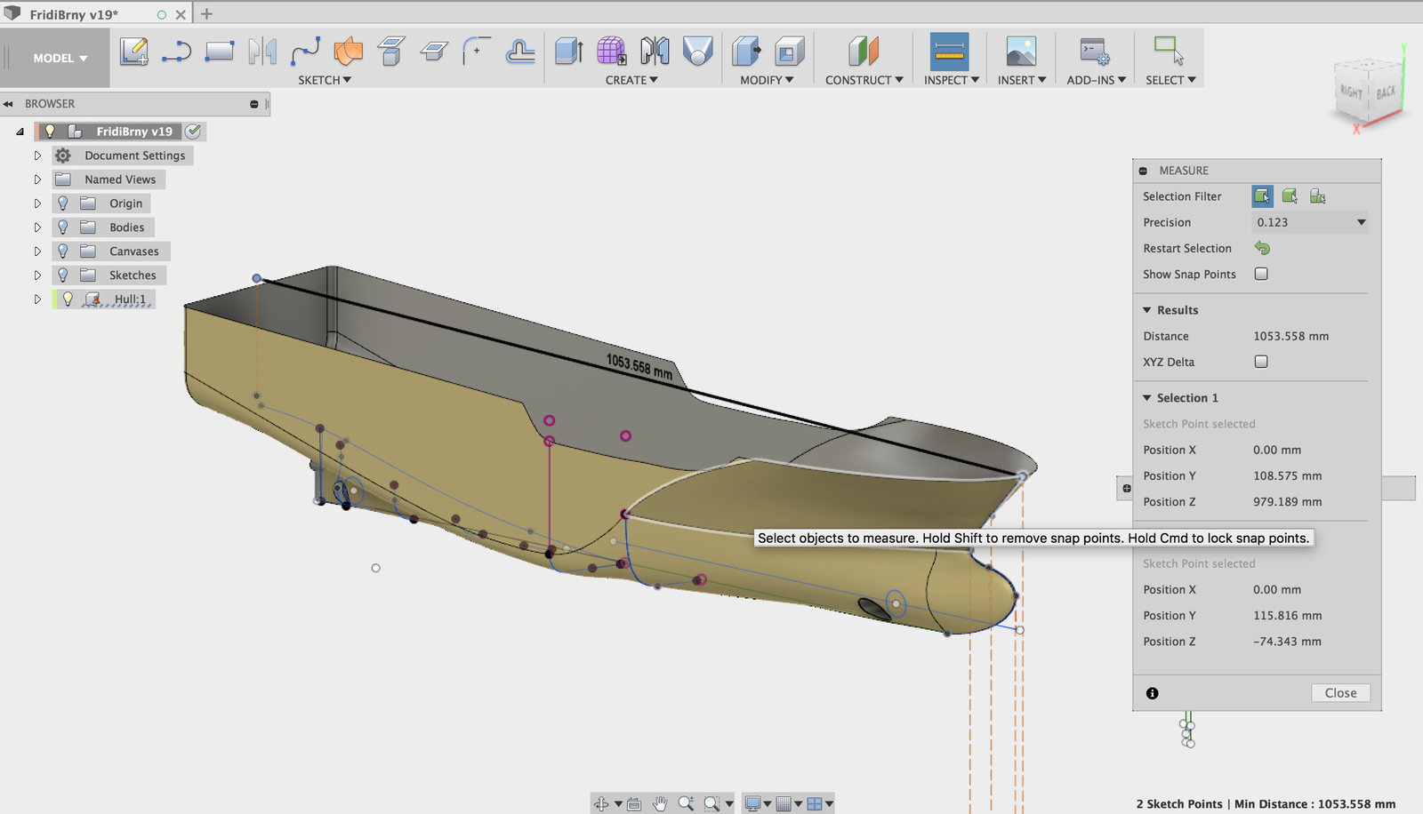

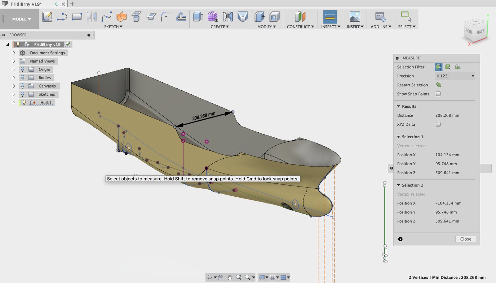

thanks for the reply, yeah I’m the designer myself. I have one of the two designs finalised, just adding the finishing touches to the larger of the two models… I’m located in Spain, but distance is not an issue it’s more the right price. I’ve downloaded the 3d printing handbook to help me also!! Very interesting book!!!

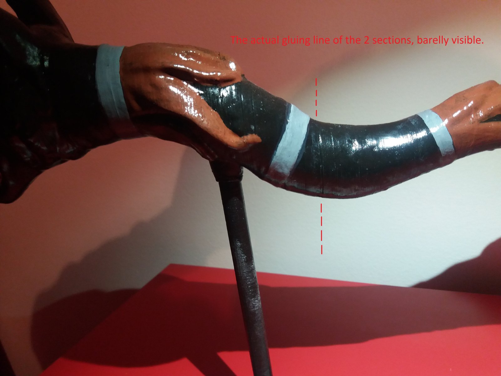

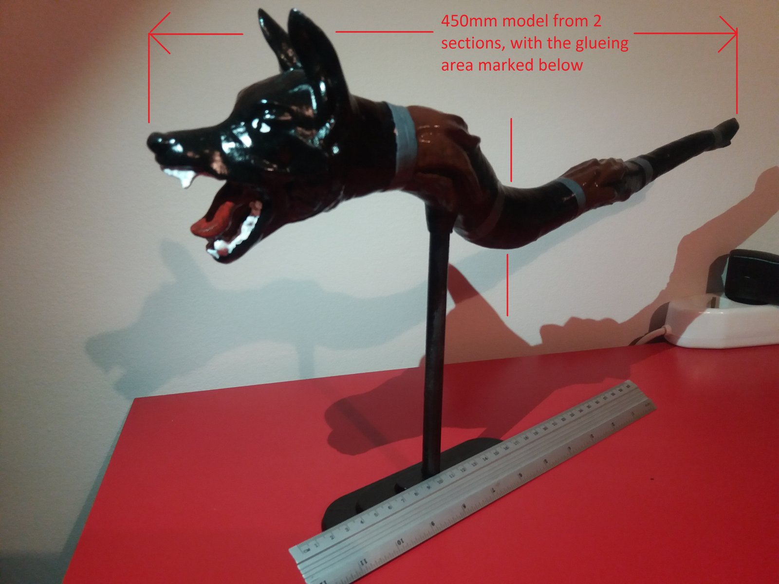

Please see the first picture of one of my finished products (450mm long, see the 300mm ruler in the picture for dimensional reference). The part on top is done from 2 components glued togher. The assembly line is hidden (I present it in the second picture) and the part is finished and painted.

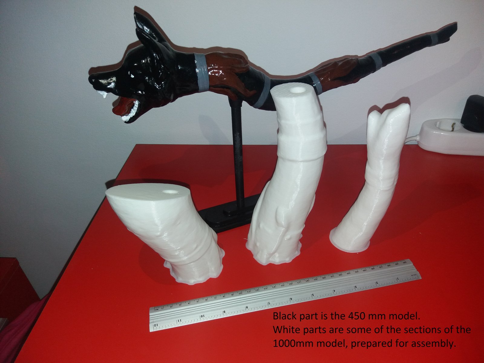

As I said I am working now on a 1000mm model, it is actually the exact same model, scalled up. Please see the 3rd picture with some of the sections printed and in comparison to the original 450mm model. I should be able to have the final part (assembled, finished and painted) in this weekend and I will post another picture if you are interested.

Can you send me your email address, I’ve a few screen shots with dimensions of my model for you to have a look at for some advice on printing my model, my email is m5currie@hotmail.com
get in touch and we can start discussing some techniques for my design to be printed.
