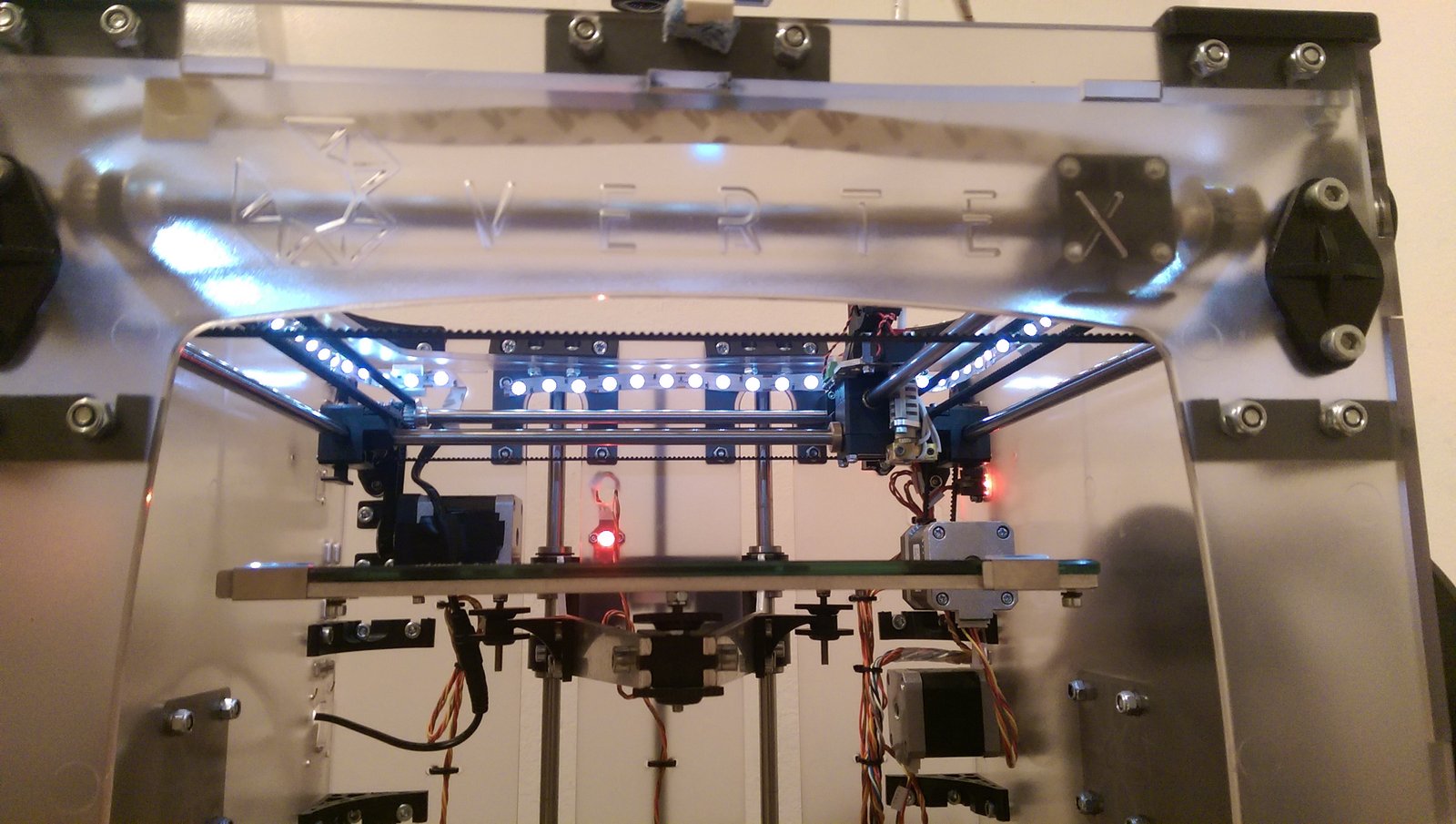

Hey , i added some lights my self below 's the outcome :slight_smile: I useda regullar led strip light (155cm) and attached it with this great design

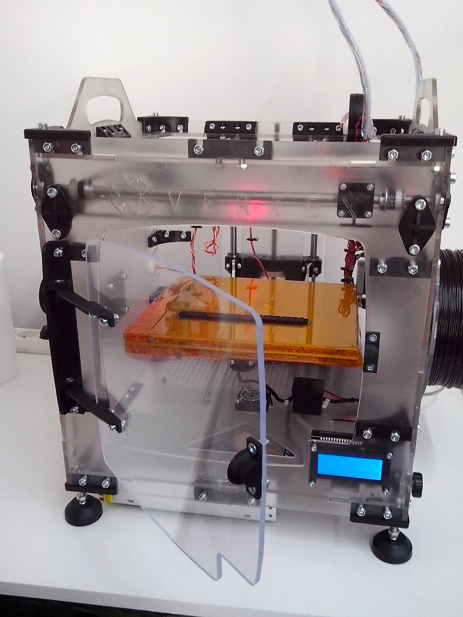

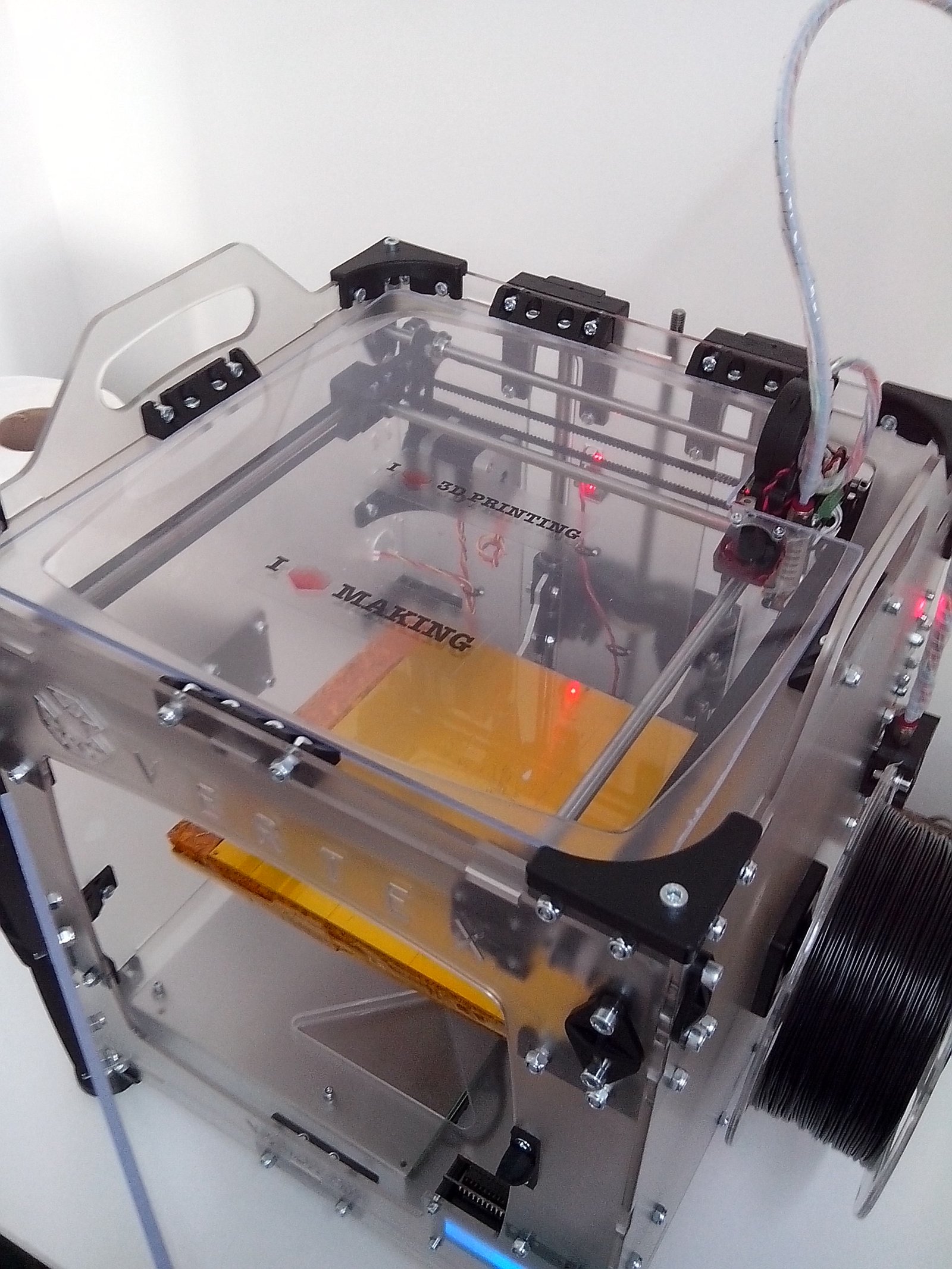

I have added a plexi front door and roof to my Vertex, it protects mechanical part from dust.
I’m looking for filament dust protection to be placed directly on the printer, I can’t found it on Thingiverse so I’m thinking in design it by my own… and share it of course!
