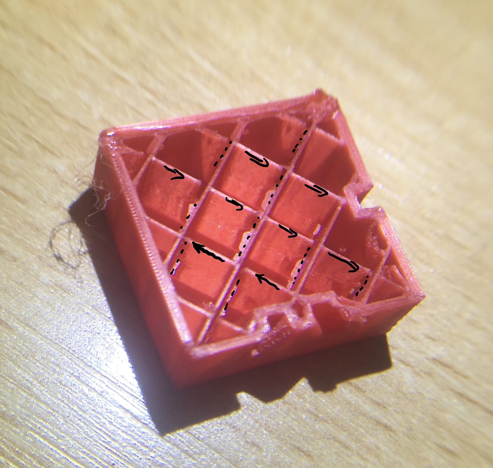

I have an issue with my homebuilt hypercube by Tech2C. Im using a MKS GEN L board with TMC 2208 driver. The last bit of every path gets not extrudet. I tried everythig. Belts are tight, rods ar straight, tried different filaments every jerk and acceleration setting in Cura.Coasting ist turned off. At first i thought it is an mechanical issue. But the Infill showed the same symptom aswell.
There are some more pictures at imgur.

Have you done an E-steps calibration for the extruder?
For a new build that’s a good first step calibration.
Hey there, thank you for your quick response. When you mean Stepps per mm with E-Steps. Of course I did. Top and Bottom of prints look perfect. I am in 3D Printing for quite a while. But now with my first printer i built myselfe I came across this issue.
Just checking :slight_smile: so is this only an issue on the infill? If so maybe its a speed issue; the extruder can’t keep up perhaps?
I tried a lot of speeds, accelerations and jerk settings. The test you see on the pictures are printed with 45mm/s and 1000mm/ss jerk is around 8-10. No slipping or grinding at the bowden extruder.
