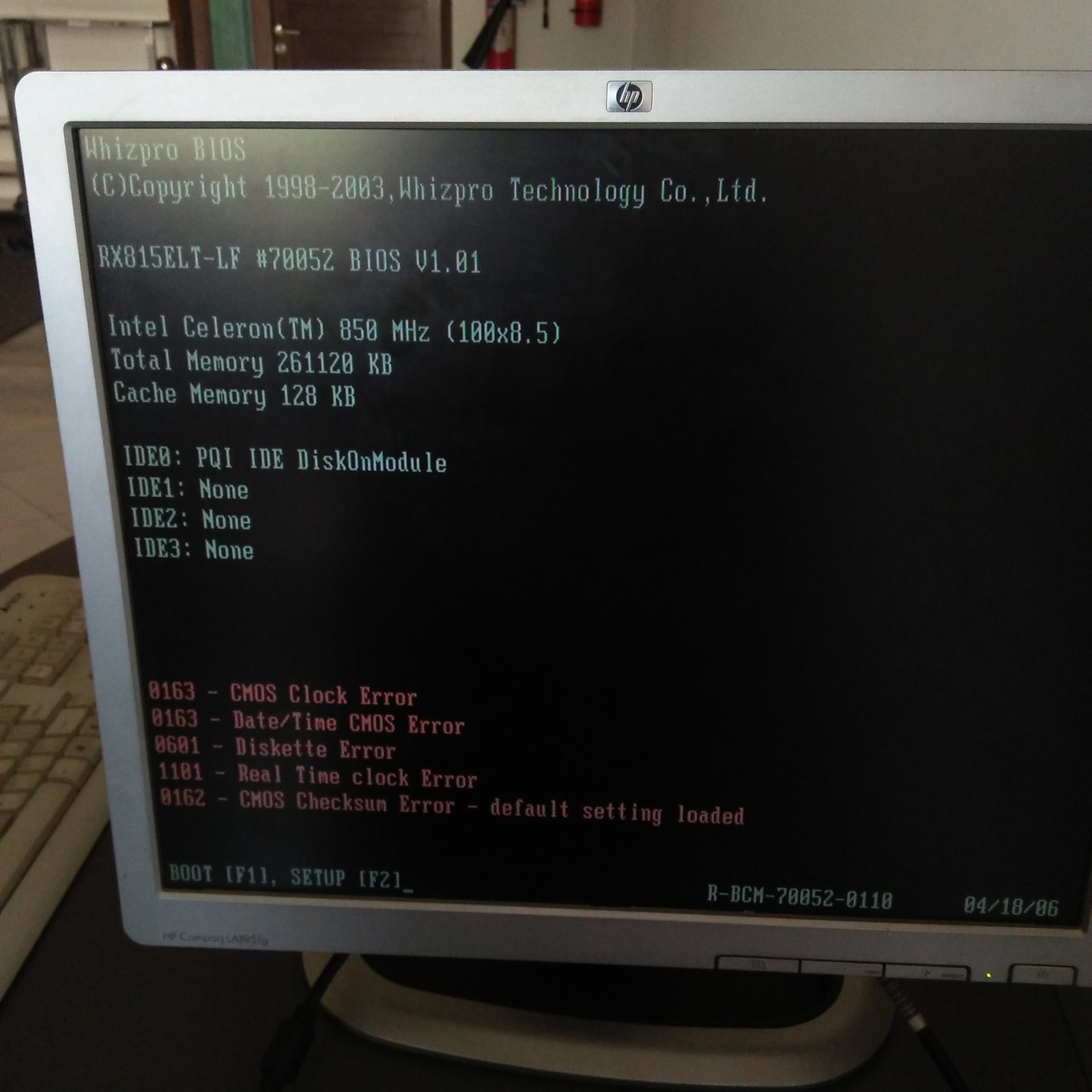

I’ve attached keyboard and monitor but it shows different errors like time/date

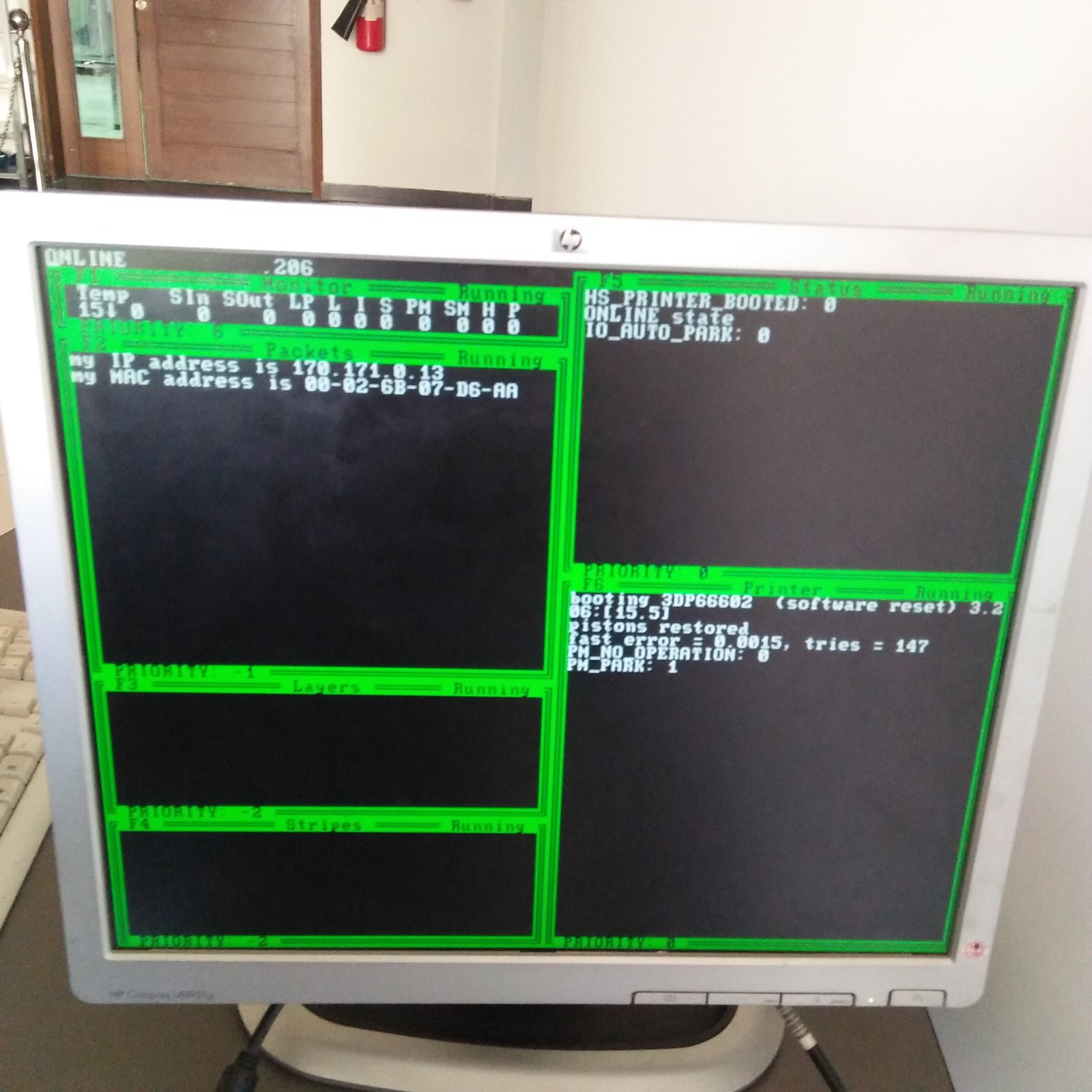

When I press f1 (boot) then it shows screen like this
Typical, I as mentioned the BIOS battery is dead. You must replace the battery on the motherboard. Diskette error will probably does not matter in booting but can be switched off in BIOS setup.
The other photo shows online state and normal operation I think so this means you can print. If you need any cheap quality binders for the printer send me a message.

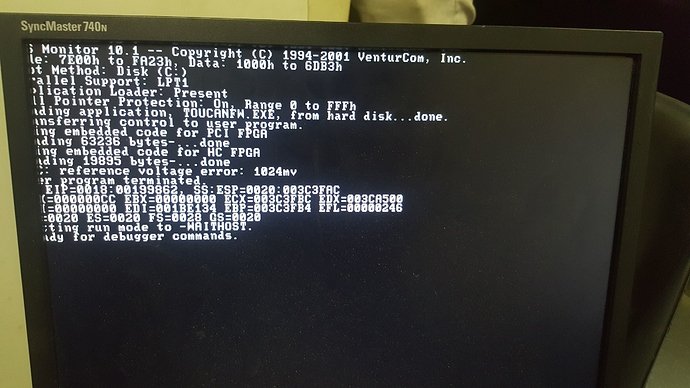

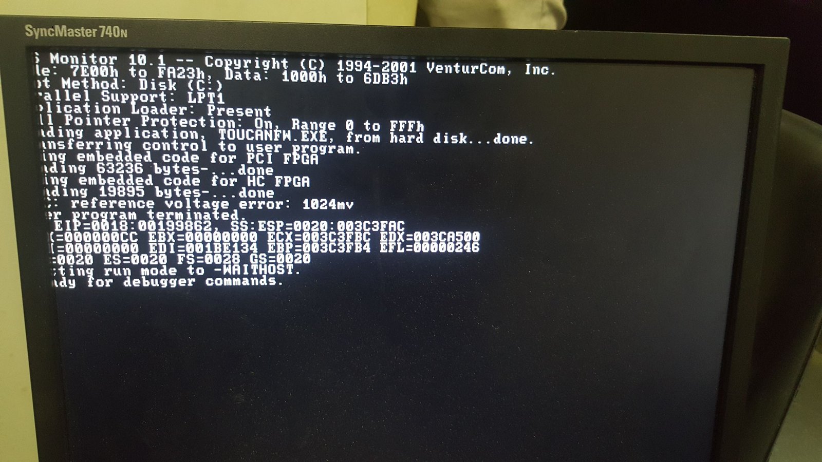

hey guys i have a zcorp z510 here it has a booting problem when i try to switch it on it goes past bios and then when its starting to load it tells me there is a reference
voltage error in the adc
