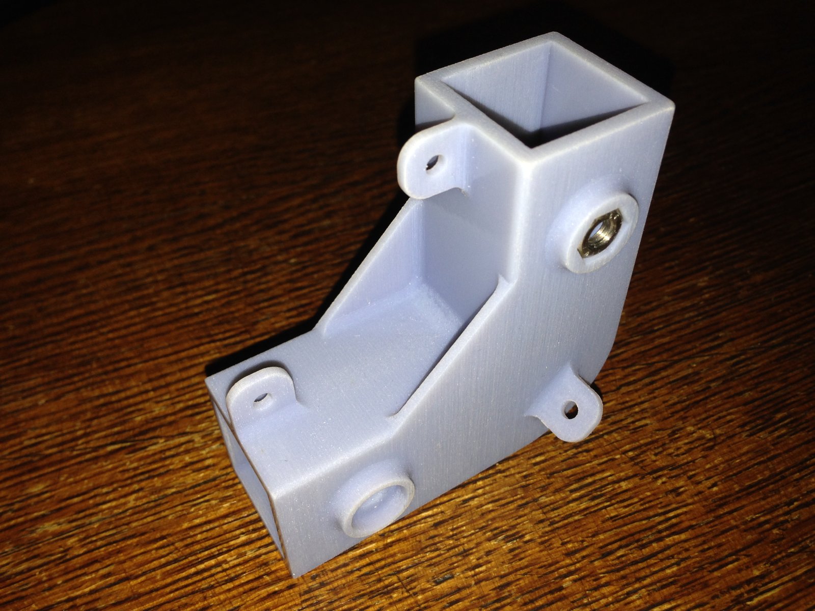

What’s the best way after removing the support, to manipulate the surface?
What are the experiences of other users from Polyjet?
When I bought the Objet30 Pro, where there samples with the printer with a smooth surface, also the Vero clear.
For example, how can I give the printed object in annex, a smooth surface or a transparent view?

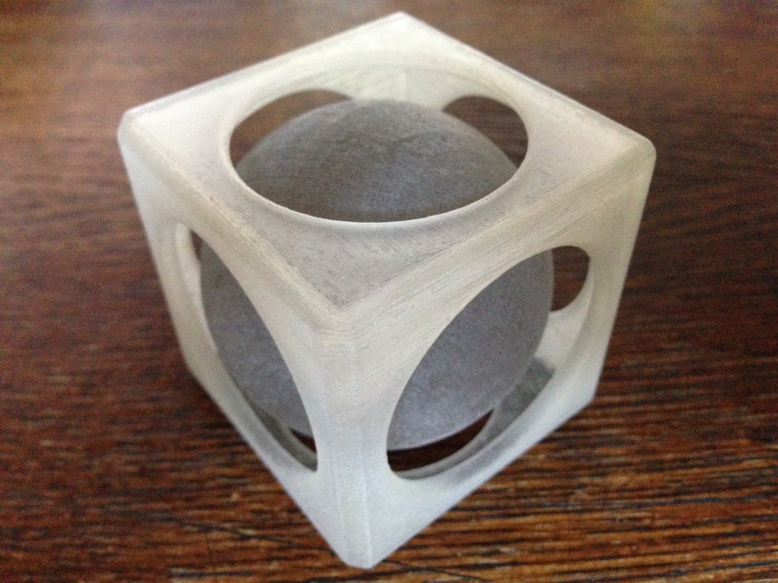

In options, choose ‘glossy’. ( You can right-click this too ). With gloves, use sodium hydroxide to get a better surface finish after you have removed the support material with power washer. Veroclear does seem to have a cloudy appearance. I’d like to be able to eradicate that too.
Thanks,
But the problem when you use “glossy”, is that you always have one side with support.
And also the hangover points (I don’t know if this is correct English) are covered with support.
The surface between glossy and the parts covered with support are so different, that I almost not print glossy.
We will try tomorrow the NaOH.
I hear what you are saying about the glossy function. There is the option of an epoxy elastic acrylic varnish but it’s expensive and hell to use. Please also, if you use NAOH make sure you dilute it with the correct amount of water and be aware that it is caustic ( so no daughter around! ). I don’t want you to have any misfortune from my recommendations.
Yep… it’s working perfect!
A piece that I made a few weeks ago in Vero blue, was after weeks still feeling spongy.
Because it was so spongy, was it soon dirty.
I placed the piece in NaOH last night and it’s perfect now.
I will receive one of these day’s a polish-machine for in the jewelry-sector, with different types of polish material, so that I can give it (hopefully) a smooth surface. Especially to reduce the different between the surface from the smooth printed surface and the parts that used support in one printed model.
I’m not sure yet, to place the square with the ball in to NaOH. I love the results already, but I think that it can be better…
