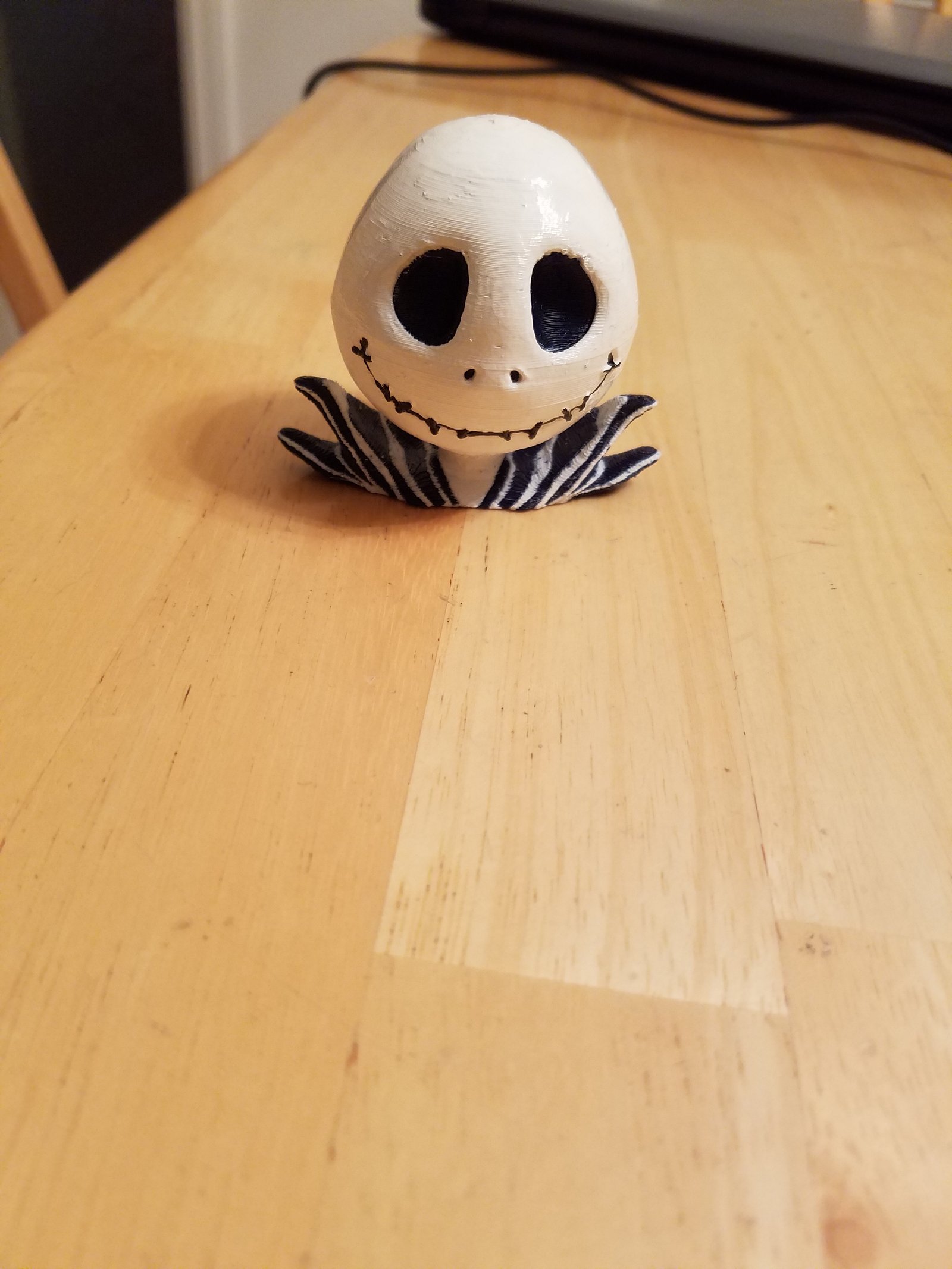

Turn on purge walls in your advanced settings on MB desktop this should catch most of your nozzle drips. Or more advanced software can do an ooze shield witch also works. First picture has an ooze shield while printing the 2nd is the completed print with ooze shield removed.
