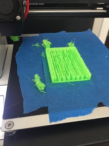

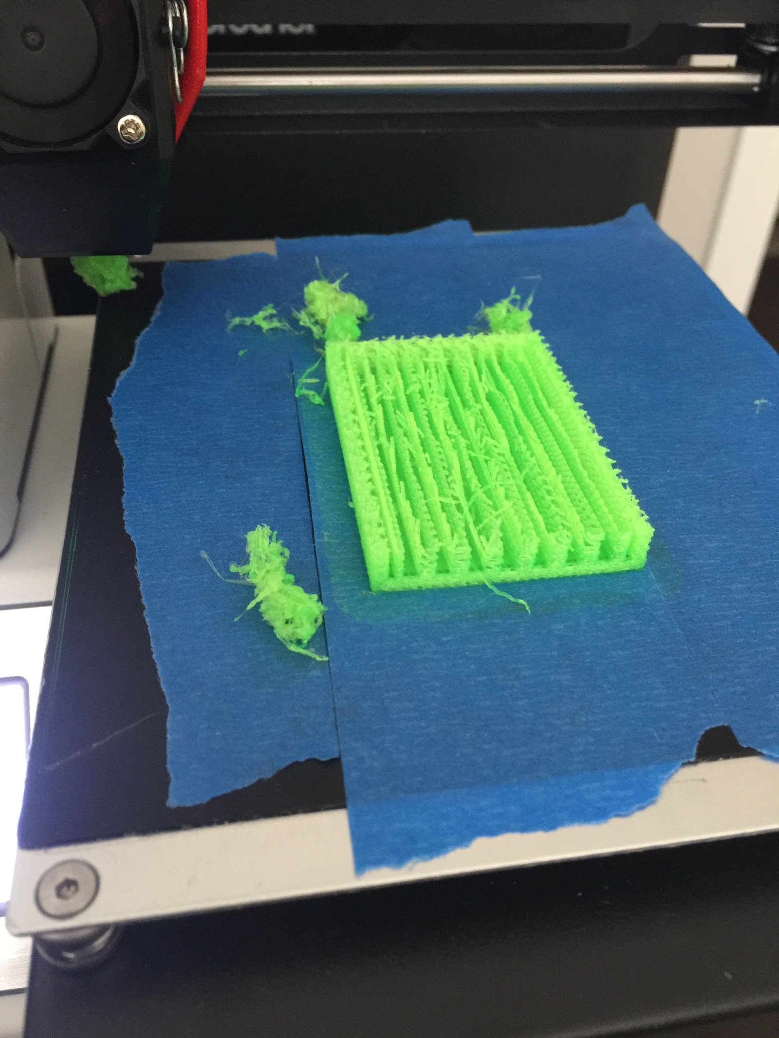

I’m struggling to get a simple print to work on my new Monoprice printer. Here are photos of several different prints. The intended print is just a box with one end open. Should be simple.
The support kept getting screwed up and then plastic would get stuck to the nozzle, and now this last one the base printed ok, but then it all just got stuck around the nozzle.
Can’t get Monoprice printer to print a simple box. It screws up the supports and once those fall over it becomes a mess.
What are you using to slice the print? usually when the filament starts to stick to the nozzle my feed speed is too fast so i drop it a few %
I’m using Cura. I’m working on cleaning the nozzle now in case that’s a problem. But haven’t had the chance to do another print yet on a cleaned nozzle. But I didn’t notice a clog when taking things apart so I don’t think that’s it.
I’m also trying to figure out how to make my side walls solid instead of just infill. Even at 100% infill setting they still aren’t solid.
