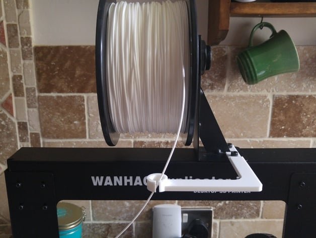

There are several upgrades for it.
1. print a upgraded spool holder. The one comes with is to short for 1k spools.
Maker Select V2 Spool Holder Mod by toastedsilicon - Thingiverse I use this though I messup my print didn’t go the hole and hotglued it to the back.
Remixed Maker Select V2 Spool Holder Mod with Bearings by gammagec - Thingiverse looks improved version
Go thingiverse type in monoprice, Wanhao Di3, Maker select. see your self what you can print improve it.
