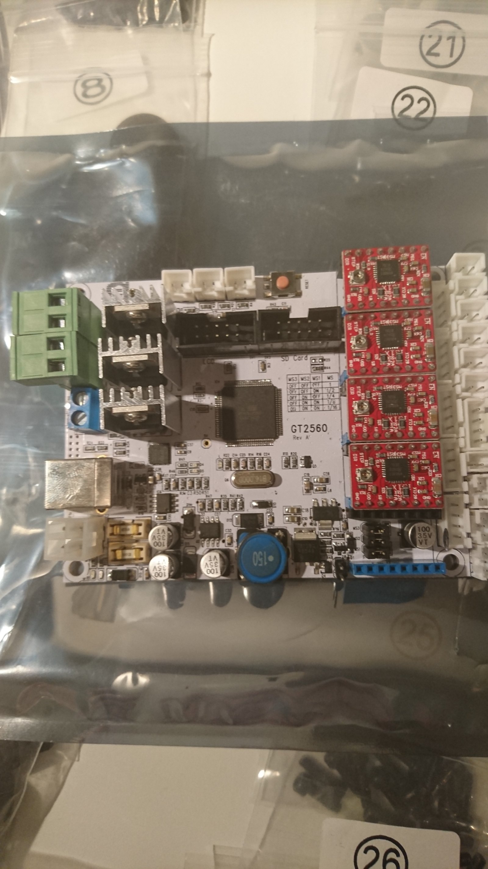

As expected thatâs a GT2560 board in case you were wondering! There, I saved you about an hour of internet rummaging

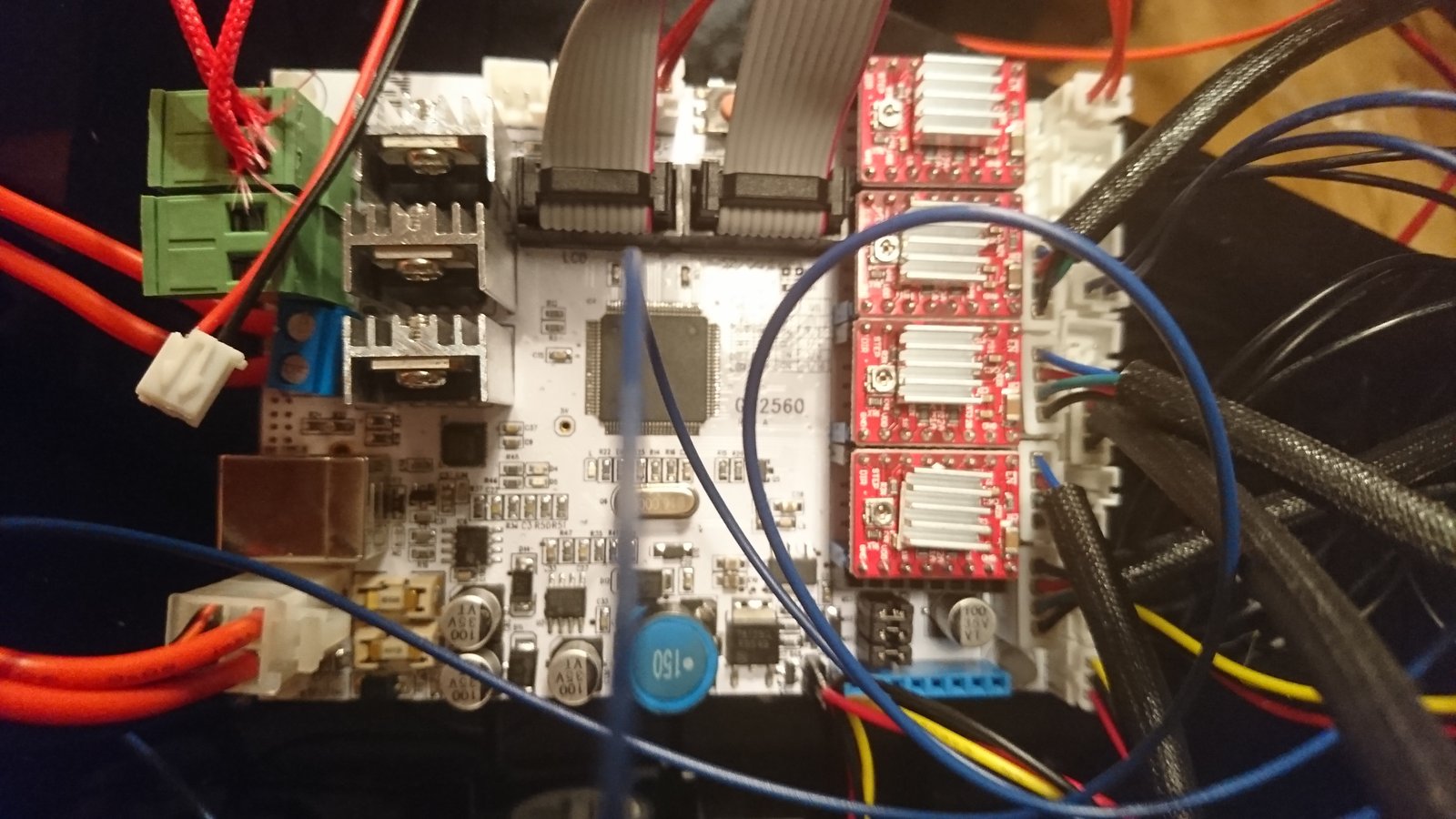

Here is a pic of my connections.
Blue wires is my Hotend Heater
Red/Black is my Heatbed Heater
Left Hand Temp (Red/Red) is my Heatbed sensor
Right Hand Temp (Red/Black) is my Heatbed sesnor
It looks like you have a sensor in the wrong place.
Cheers
Dave

Oh so stupid⊠It works! So simple. It was the temp wires that was wrong. Thanxs!
