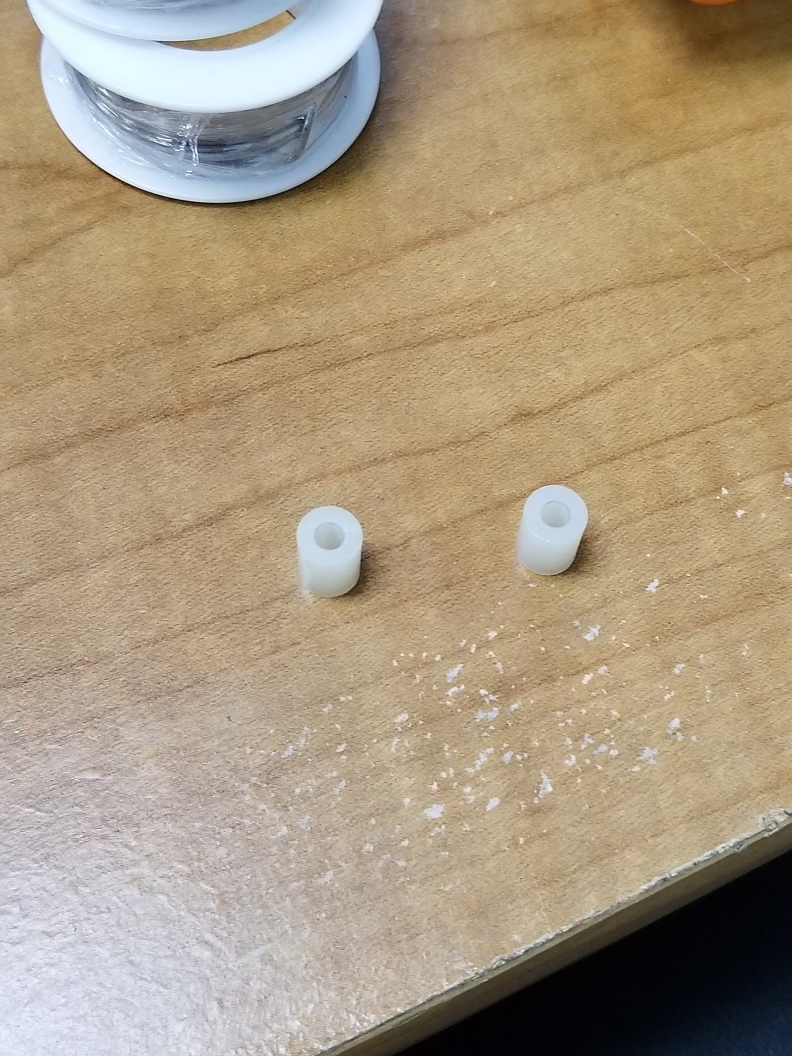

Thanks for that. I wish that I had seen your directions before I basically did just that. It seems to be working. However, some ptfe bushings fell out that I can’t identify where they go. I thought that they were spacers for the 2 screws, but they won’t fit in that assembly. Any idea where they might be from?
