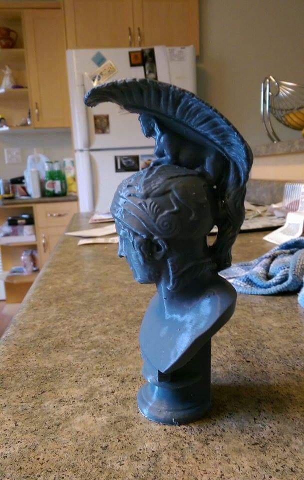

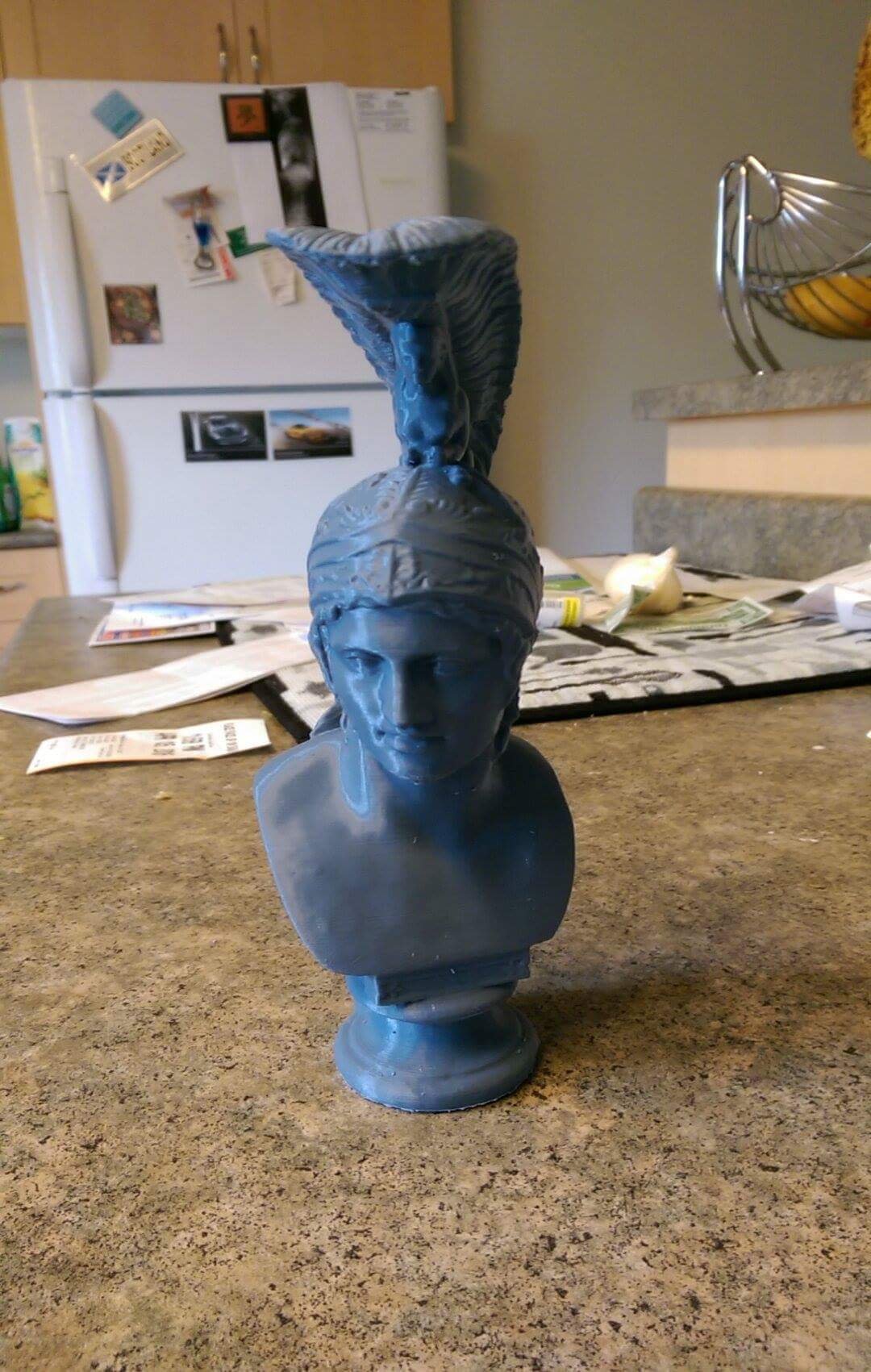

No problem, sorry I couldn’t remember all of the settings for the T-Rex print, but here is two quick pics of a print that just completed. Please keep in mind this is fresh off the printer, and literally nothing has been done other than removing the supports (not very well at that).
The settings were,
print speed 20 mm/s
travel speed 100 mm/s
density 20%
0.8mm shells
0.8mm top/bottom
100 Microns
ColorFabb Grey-Blue
Temp @ 200 (ColorFabb seems to need hotter temps, at least from my experience)
Full supports, otherwise it would have been impossible (at least for my printer).
On that note, I’m never using Cura again for supports. Virtually all of the supports failed, but I let it keep printing because I was convinced as long as the supports on the helmet worked the print should work out after a bit of sanding. Thankfully, those supports did work, and the print finished. Granted, a fair bit more finishing work is required, but all in all it turned out pretty nice.
I’ll send a pic when it’s sanded and painted :wink:

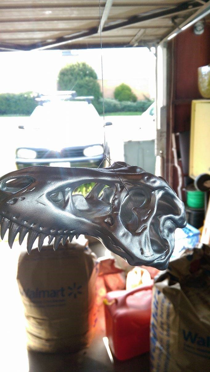

Hey Bud,
I’m not going to be able to finish this for a few weeks, but here’s a sneak peak of what it looks like after the first coats. Once these bloody exams are out of the way I’m hoping to wrap it up in a couple days.
Your work really looks cool, and good luck to your exams! Thanks again for our sharing.
