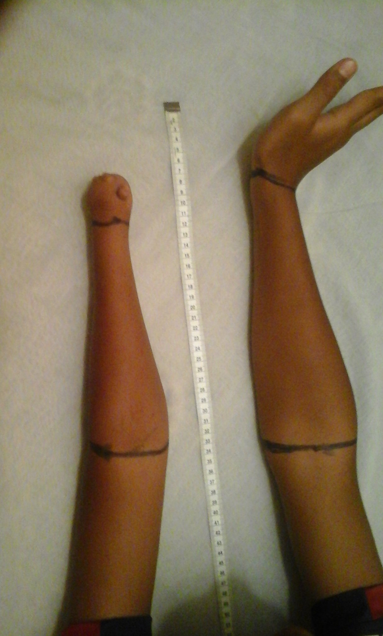

In the Enable form, they ask to push some personal information and 3 pictures about the hand. So, this is why they decided that the model will be more “Phoenix” instead of “Raptor”. which make the task more complicated. My understanding :
My nephew hand is missing enough inflection and this is why the hand design must include the forearm. So, the design must more go for a Phoenix/Unlimbited than a “Raptor”.

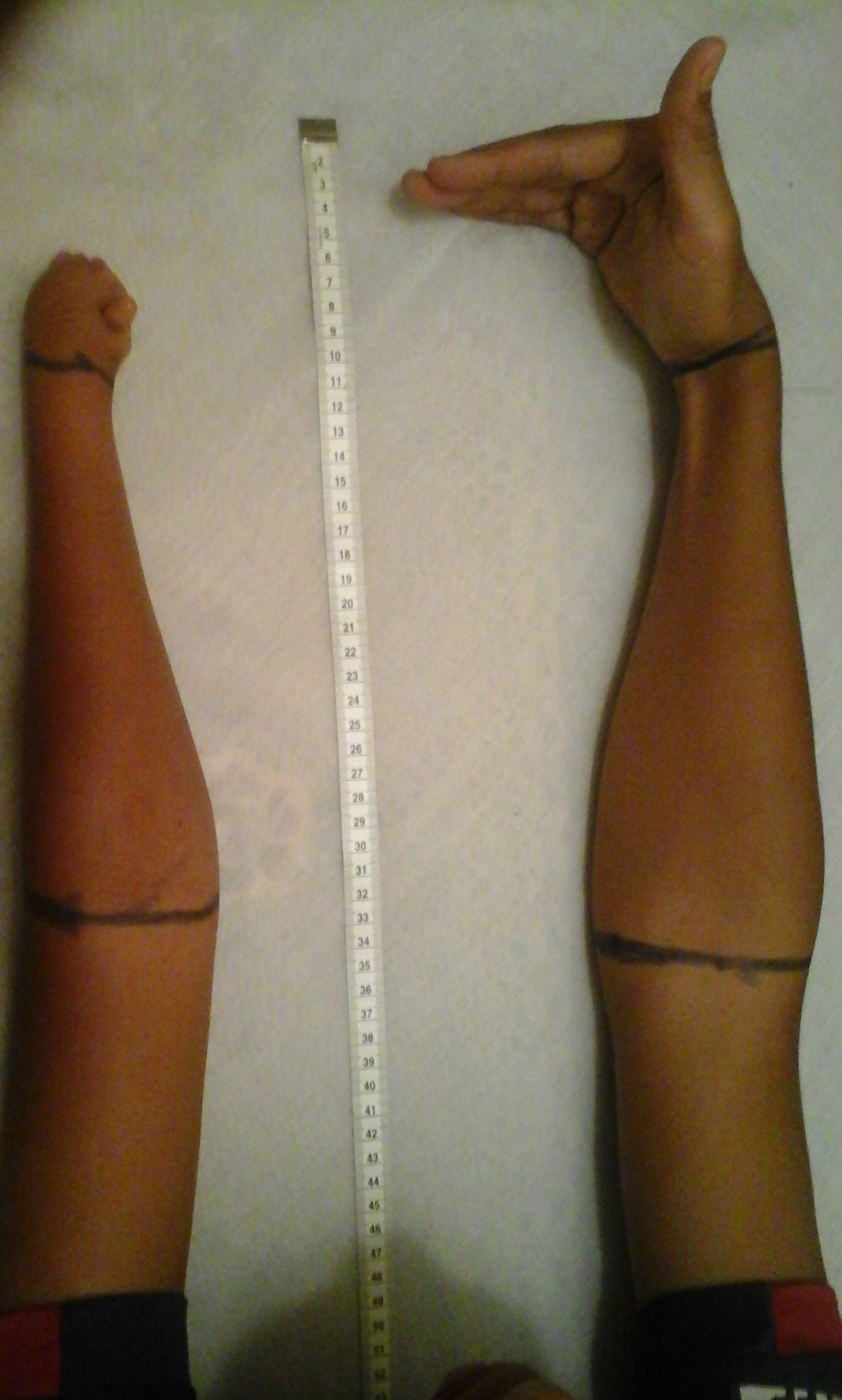

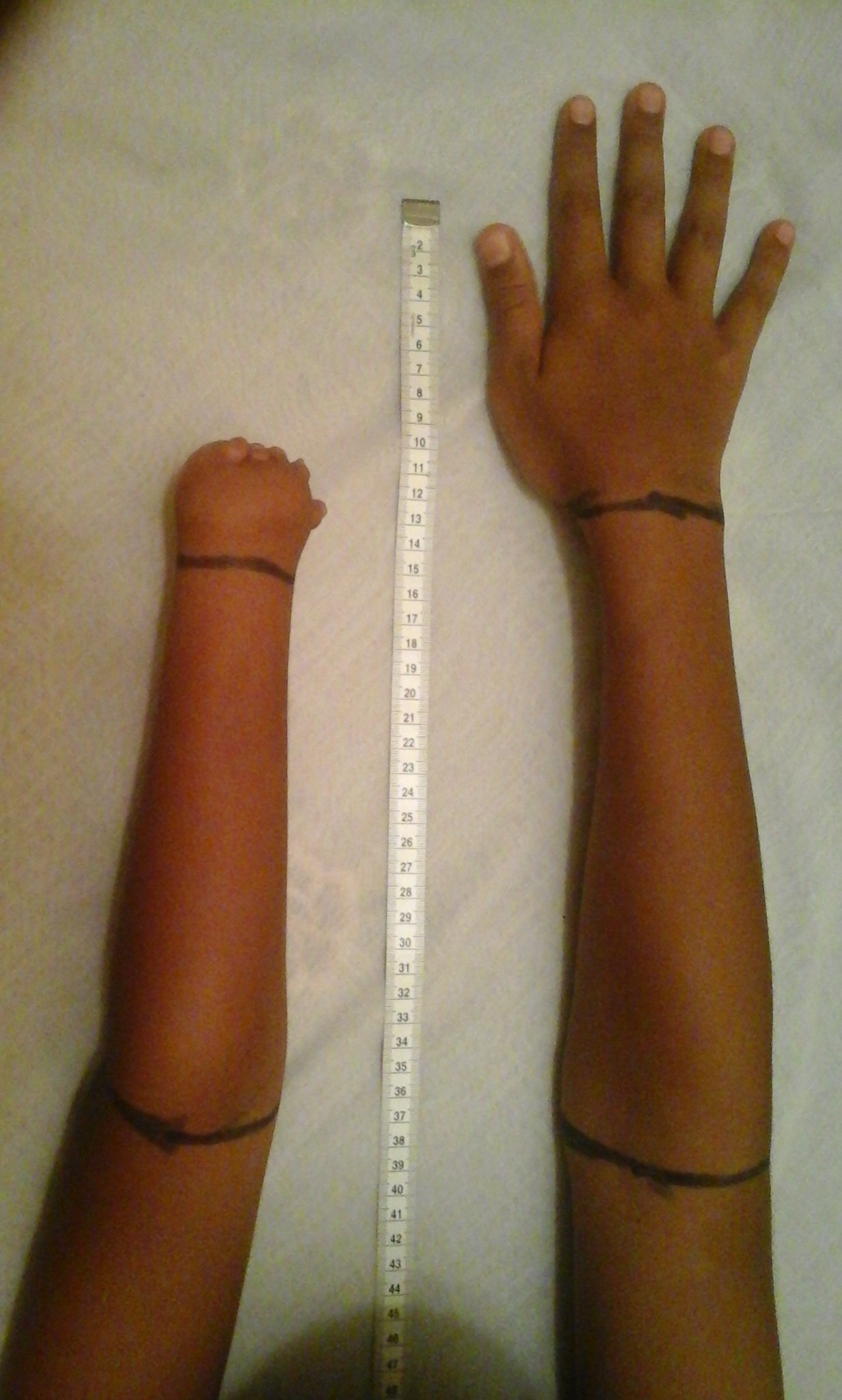

Please let me know what you need to build the right adjustement.
You can find enclosed 3 pictures asked by Enable. You can see the measurements. And please don’t hesitate to ask if you need more information.
