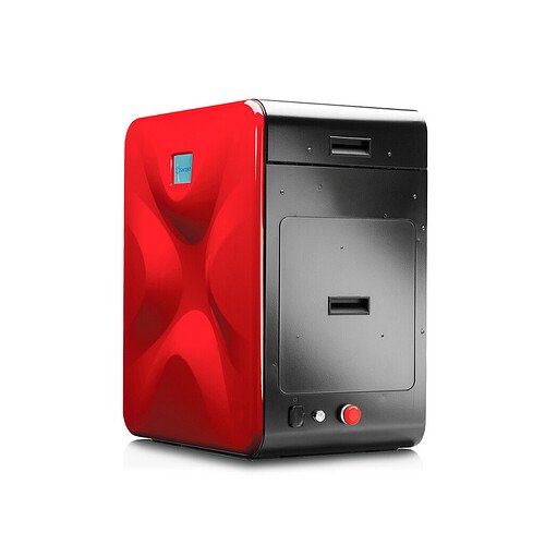

With a 15K budget (£ ? $ ?) you could just about scrape into the SLS market and that’s another possibility. Again, the layer bonding is better than FDM and dimensional accuracy is high. SLS is also a good bet if you’ll be producing multiple parts and/or making small production runs.
Someone selling a Sinterit Lisa with upgrades over in the “For Sale” section.
